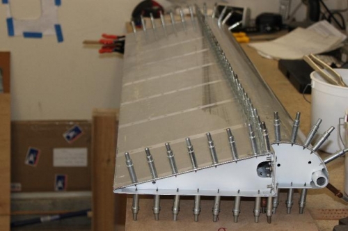

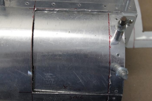

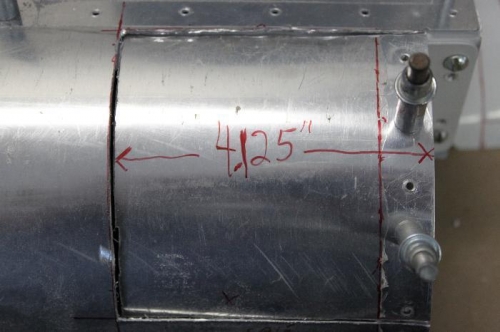

The left aileron has the electric trim assembly to finish installing. I really was nervous cutting the perfectly good nose skin. After I finished match drilling the spar and outer aileron ribs and nose ribs, I set out to make the electirc trim access cut. I thought it was supposed to be 3 1/2 inches wide plus the width of the nose rib flange (5/8) for total of 4 1/8 inches. Made the cut only to eventually realize I needed 4 1/2 inches. Don't know why the plans called for 3 1/2, Live and learn. No problem. Cut the additional width and proceeded with the installation.
Match Drilling complete
Used Dremel Cutoff Wheel to open the skin.
How much to cut??
How much to cut??
