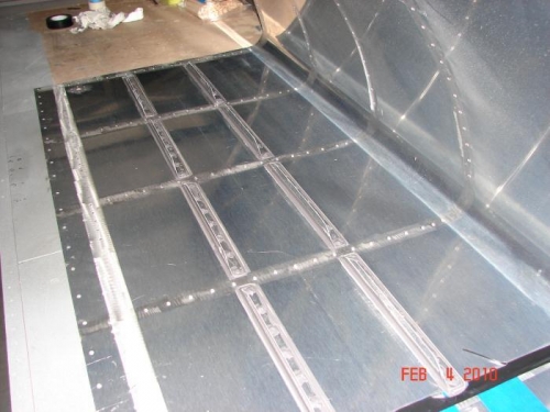

Manual Reference:  Sec 7-7 DWG 16A
Brief Description:  Rivet / Seal Right Fuel Tank
I mixed up 3 oz of sealer.
I began by taping off the area where I did not want sealant.
I removed the tape as I went. Sorry I did not take photos before removing.
I just use blue painters tape so it was easy to remove.
I back riveted 8 stiffeners before running out of sealer. I will bet better at estimating.
The process of making the fillets and sealing the rivet heads went well with minimum mess.
I cleaned up the machine heads with a bit of MEK.
I called it a night...
Riveted 8 Stiffeners
