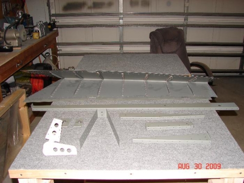

Brief Description:  Final Fitting of Right Elevator
Final match drill the right Elevator spar to the skin.
Final drilled the counter weight.
Final drilled the Elevator control horn
Final drilled the fibs to the skin
deburred and beveled parts as needed.
Dimpled the ribs and skin
Etched primed the skeleton assembly. followed by epoxy primer.
I cound not be happier on how the right Elevator fit together. Seemed to flow according to the plans and no surprises during the fitting and assemby.
Should be ready to rivet and finish the right Elevator tomorrow.
