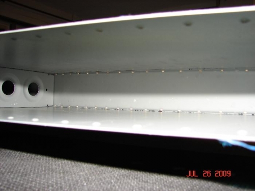

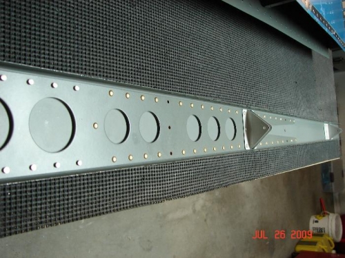

Brief Description:  Epoxy Primed Ribs and Internal Skins
Cleaned internal skins scotchbrite and Dawn soap.
Applied (2) light coats of SEM self-etching primer.
Applied (2) light wet coats of PPG Epoxy primer.
Applied (2) light wet coats of PPG Epoxy primer to all ribs and spar components.
I forgot to take photos of primed parts, so I incuded some photos here after I riveted the spar together.
Rear Spar Primed and Riveted
Internal Primed and Riveted
