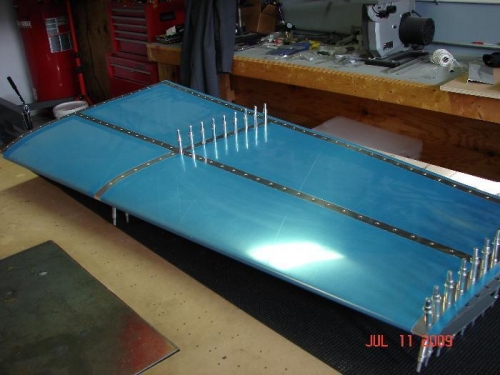

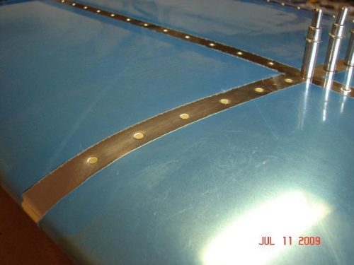

We had a little trouble with the very forward rivet and have to drill it out and replace it. Helper #1 has perfect hands and arms to reach deep inside the skin. Those little asian hands really made the difference, along with a small tungsten bucking bar.
We stopped at this point discussing the bottom rivets... I ordered the optional MK-319-SS rivets for the bottom side. But after seeing her ability to reach inside the skin. We may use solid rivets.
I will have to sleep on that option. 319 rivets should be here on Monday.
