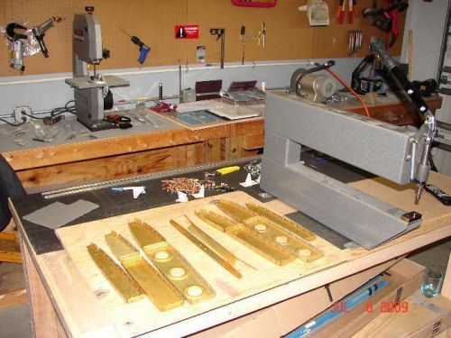

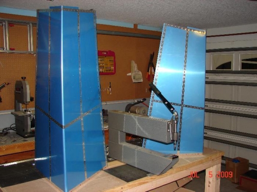

Put some time in today...
Dis-assembled the HS, deburred, dimpled the Ribs and Skins.

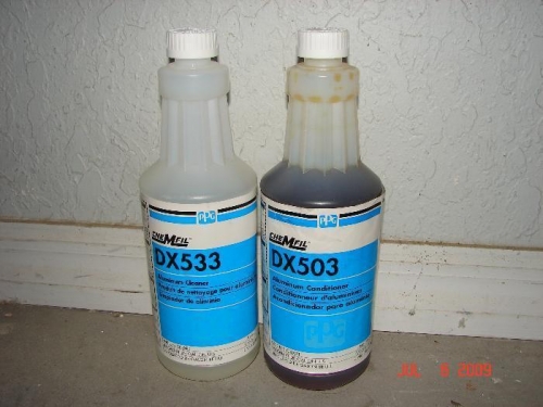

Acid Cleaned / Etched the Ribs with PPG DX533
Alodine / Conditioned the Ribs with PPG DX503

Maybe???? The more I read the more confused I get about protecting the bird from corrosion.
Alodine is great but it is difficult to do... unless you can dip the parts.
Folks talk about:
Just SafeGuard 6100, works good and is safer to use. needs to be sealed
Just Acid Etch the parts with DX533 and apply epoxy primer.
Just Self-Etching Primer followed by an epoxy primer solution.
Just rattle - can with a Self-Etching primer.
Just leave the alclad parts alone... and Corrision - X them after finish paint has curred a year.
I live in Central Florida... about 50 miles from each coast... not so salty... But I feel I need to add some extra corrosion protection to the internal parts.
