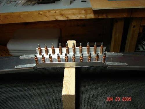

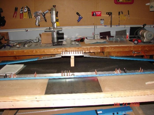

Sec 6-2 DRW3
Relief holes contoured for HS-702
I also drilled / cut and contoured the relief holes for HS-702 (2) and also bent these parts to the required 6 degrees. I then cleco'd the parts together with HS-710 / HS-714 to check the fit.
I am satisfied with the results.
HS-702 (2) - HS-710 / HS-714
