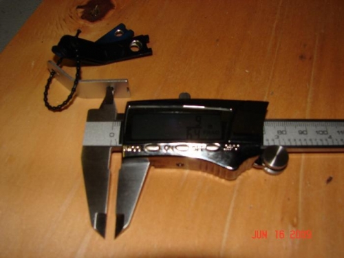

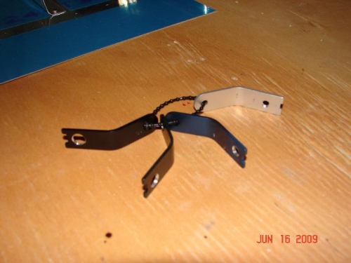

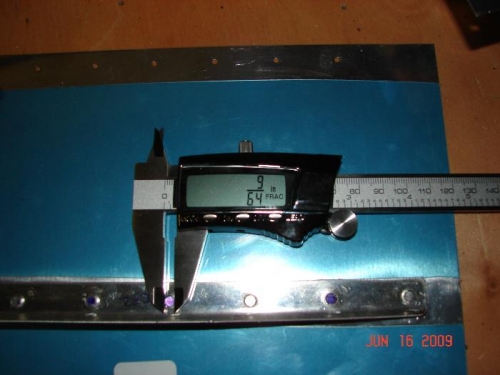

Helper #2 modify the Rivet Gauge to make it easier to measure the shop heads...
Either is fits or it doesn't...
BTW... I bought the Micrometer at Home Depot for $35... it is all metal and read in fractional, decimal and milimeters... It feels good in your hand and is smooth in operation.
