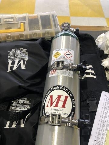

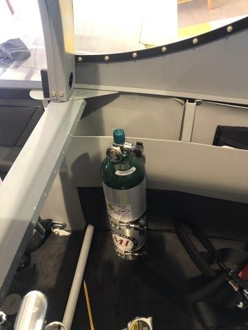

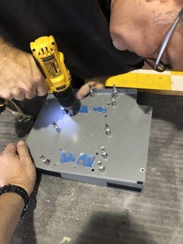

It was now time for the oxygen system install. Rob placed it on the right side of the baggage area in his RV7. The install involved a 1/16 inch doubler on the side panel. The install came out fantastic. The gauge can be read and the bottle reached easily from the pilot seat position.

OSH oxygen system purchased
Doubler plate for clamps
Install complete!
Install complete!
