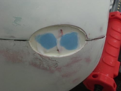

I removed the cowl pin covers that came out fairly easy with the plastic food wrap keeping the micro off them. The surface came out great and I mixed and placed Super fil over the indentations where the washers were used for spacers and put peel ply over the epoxy.

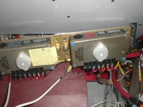

I worked a little bit on the regulators as I didn't leave enough slack in the wires to make it easy to work on the regulators in that position. I cut some lacing to get more slack in the wiring to get to the screws easier on the regulators. I will make more slack in the wires for future work on the regulators when putting the new wires on the terminals.

Cowl pin covers removed and filled
Worked the regulator wires just a bit
