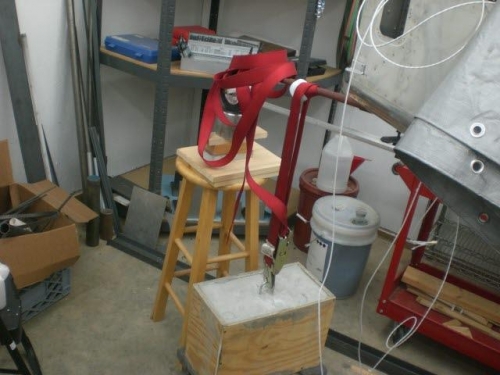

I leveled the fuselage in the last session which requires weight on the tail spring to keep the airplane from nosing over. I was using a 5 gallon bucket but wasn't comfortable with only having that so I went to the airport to get my home made cement block tail weight (which weighs about 125 pounds) and put it in place of the bucket

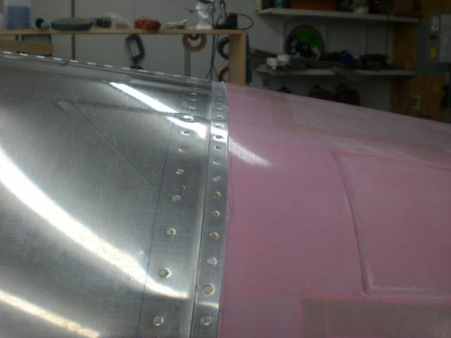

That done I got the saw horses out and set up to cut the top cowling. I made the initial cut leaving extra for sanding and fine adjustment. After a number of iterations involving removing and putting on the cowl I got it to the place where if fell into place. I still have to trim it more as there is no gap at all really so I have to get it to the place where there is room for paint buildup to fit also.

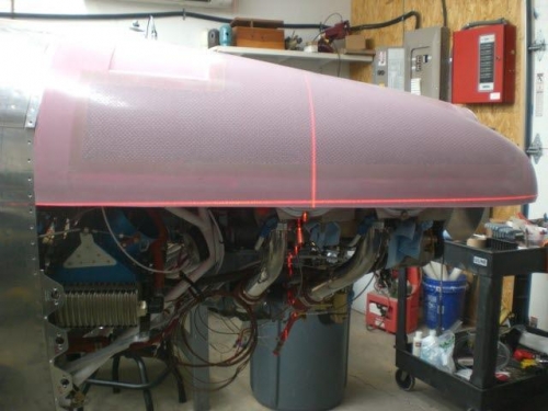

I set up the laser level just to see how the cut lines would be and it looks like it will work beautifully!
Concrete Block for Tail Hold Down
Cowling Trimmed
Cowling Trimmed
Lasar Level for sides
