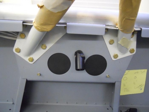

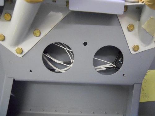

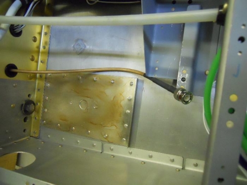

Received a care package from ACS today. Added the one nutplate which was needed to finish up the cover for the bulkhead cap. I also added some snap bushing for the RG400 cable where it passes thru the spar cap, then terminated the cable with a BNC connector. Next I addressed a cosmetic issue on the right side under the seat back support. I didn’t like the look of the visible wires for the headset jacks and the wiring for the rear map light which is visible thru the large holes in the F817 seatback support plate. I cut some .025 stock to fit behind the seatback support plate and then added a couple of nutplates near the corners on the bottom of the plate. The maplight will hold the top of the plate in position. Painted the plate flat black and temporarily installed. I need to complete the wiring to the small toggle switch and the maplight before I call it done.
BNC connector added to RG400 cable on left side
I don't like seeing these wires
Cover inside support plate-no wires showing
