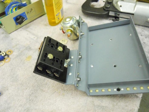

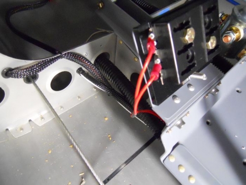

Brief Description:  E-bus wiring

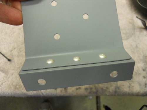

Ran two 18 gauge wires from the switch console to the battery area for my E-bus. I fabbed a mount from some angle and a .040 plated to bolt to the battery box. This mount will be used to secure the bus. I am planning on the E-bus providing power to the Garmin 430W-one circuit for the radio and one circuit for the GPS. Hopefully in the event of electrical failure—alternator, VP-X meltdown etc, I will be able to talk and navigate. I will also have a couple of backup instruments-altimeter & airspeed. Should be enough to make a safe landing at the closest airport. Also, ran wiring to the power outlet for the GIB. Secured all underfloor wiring—now I need to get some organization to the wires behind the panel.—4 hrs.
Mount for E-bus
Mount for E-bus
E-bus secured to battery tray
Trial fit of E-bus & battery tray
