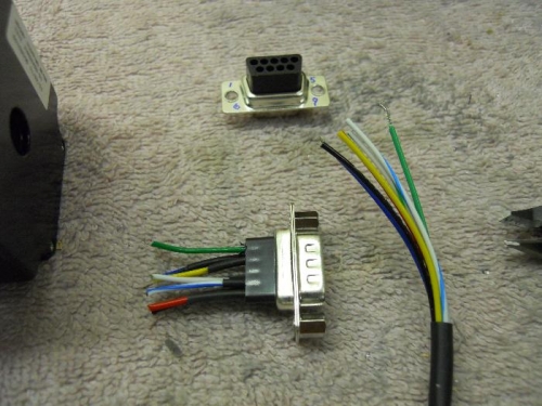

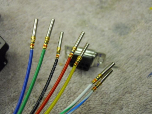

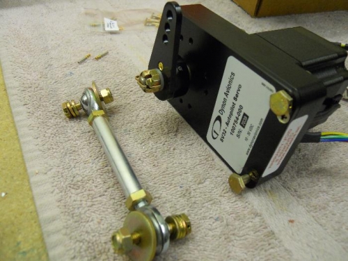

Dynon servos arrived end of last week—time to begin installation of the pitch servo. I began by cutting the dsub terminal off of the wiring I had run for the pitch servo. I need to run the wire bundle thru another bulkhead. Cut a hole in the bulkhead just behind the bell crank with a unibit and inserted a snap bushing. Opps-looks like I will have to order another 9 pin dsub. I discovered you cannot remove the pins from the dsub connector if you apply heat shrink tubing before inserting them. I stripped the wires coming from the servo and crimped on some barrels.
Servo & control rod
Servo & control rod
Can't remove pins with shrink tubing-duh!
Servo wires with barrels crimped
