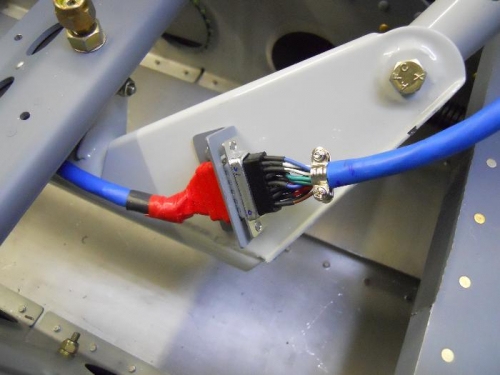

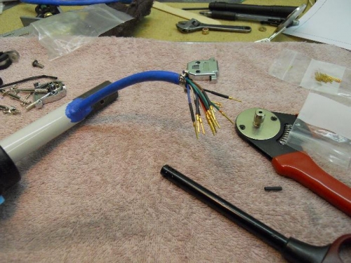

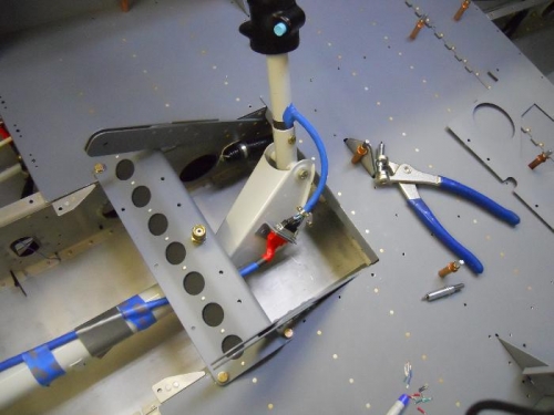

I shortened the rear stick an additional .6”. This should allow for a narrow clearance with the back of the front seat frame. After re-attaching the Infinity grip to the stick, I used some blue RTV silicone around the hole where the wire exits the stick. After the RTV setup, I installed the rear stick and marked where the cable needs to be cut. Trimmed off the excess cable, stripped the wires and crimped on the Dsub pins. Then I added some heat shrink tubing and reinstalled to check fit. Looks good-just need to add the Dsub shell and plug it in.
Installing pins & heat shrink
Checking fit
Checking fit
