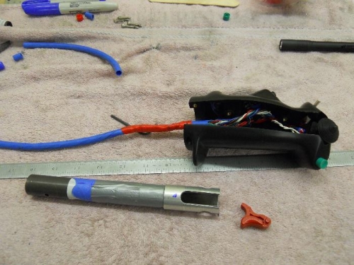

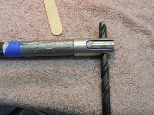

Went thru the same switch change out on the rear stick as I did on the front stick last night. I drilled holes in the rear stick for mounting to the Infinity grip. Also, cut the slot for the wiring at the end of the stick. I used the stick spacer to locate the holes and mark the slot. I soldered 4 common ground wires together, so that only one ground wire exits the tube. Drilled a hole in the left rear quarter of the stick for wire exit. Fed the wires thru the stick and assembled the grip—one more time. Installed both front and rear sticks. Darn, the rear stick just barely contacts the back of the seat—should have cut it a just a bit shorter. After the elevators are installed, the stops will dictate how far forward the stick travel will be, so I may leave it for now. These grips and sticks seem to be taking a unbelievable amount of time—hope I’m about done with them, but probably not!
Drilled mounting hole in stick

Ready to assemble one more time
