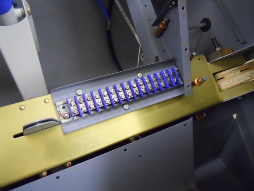

Brief Description:  Terminal Strip for Stick Wiring-Redo
While I didn’t get much work done over the Christmas holidays, I did get a few things sorted out in my mind. I have 13 wires from the front and back stick grips going to the terminal strip with 13 terminals. I was planning to daisy chain the wires, however the PTT wires have to have their own terminals. Therefore, I need a terminal strip with 15 terminals or else another strip with 2 terminals. I would prefer to have only one strip, so I fabbed up another tray for a 15 terminal strip. I dug the posterboard template out of the trash, added enough length and cut a new plate for the tray. Match drilled the holes in the existing tray, then bent the new one in my brake. Cleaned up, primered and installed the terminal strip. Then, I installed the new tray and terminal strip to the spar cap. This will work out better than using two different strips.
15 terminal strip for stick wires
