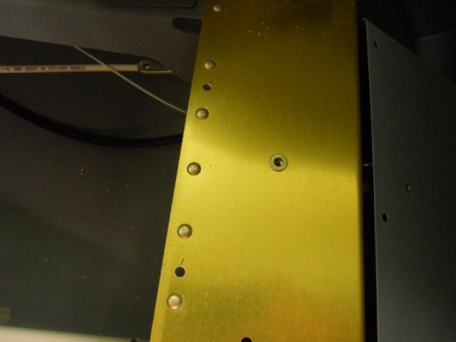

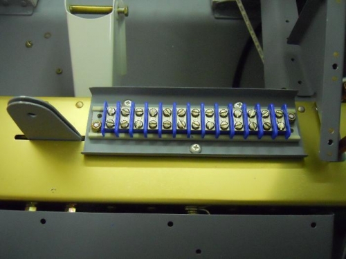

Checked what might be below the spar and appeared only the nut attached to a bolt thru one of those “mystery” holes. I drilled a 1/32” hole in the terminal strip tray, then used the tray to match drill thru the spar cap. I verified the depth from the spar cap to the nut on the underside and had plenty of clearance for a nutsert. Drilled the hole in the spar cap to 7/32” and the hole in the tray to #19. Used a nutsert puller to install the nutsert in the spar cap. Cleaned up the tray and shot a coat of primer on it. After the primer dried, I installed the terminal strip and then screwed the assembly to the spar cap. Fits nicely under the front seat ramp. Looks like it needs some wires attached!
Nutsert installed in spar cap
Assembly installed-waiting on some wires
