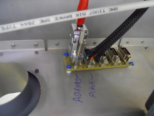

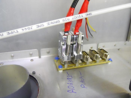

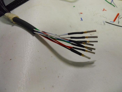

I removed the previously installed wiring from the ADAHRS unit and the pitch a/p servo—at least pulled them back from the panel area to the center right fuselage area. Cut the wires to a much shorter length, crimped on Dsub barrels and inserted into the Dsub housing. Added some heat shrink tubing and plugged in the connectors to the distribution hub. When the wing is attached, roll servo wiring will be added to the same hub. Next up is to run a single cable from the hub to the back of the panel area.
Added pins to ADAHRS cable
ADAHRS cable connected to hub
Pitch cable connected to hub
