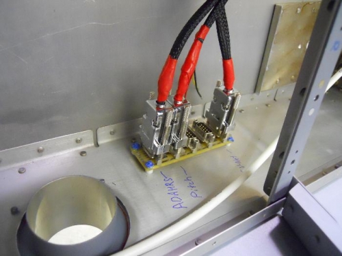

Brief Description:  Distribution block wiring-2

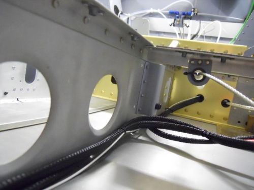

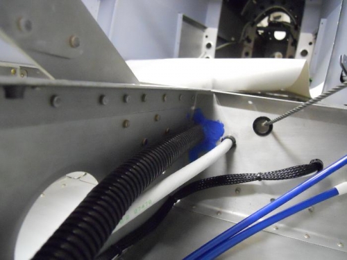

I used the previously cut wires from the ADAHRS unit to make up a harness to run from the distribution hub to the rear of the panel. Terminated the wires with pins, heat shrink tubing and installed into a Dsub housing. Plugged in to the hub. Only thing lacking now is the cable from the roll servo in the wing. Secured the wiring along the seat ribs. On the left side, I re-routed the flap wires, then secured them and the transponder cable to the seat ribs.
Distribution block-still need roll servo wires
R-secured wires along seat ribs
L-secured wires along seat rib
