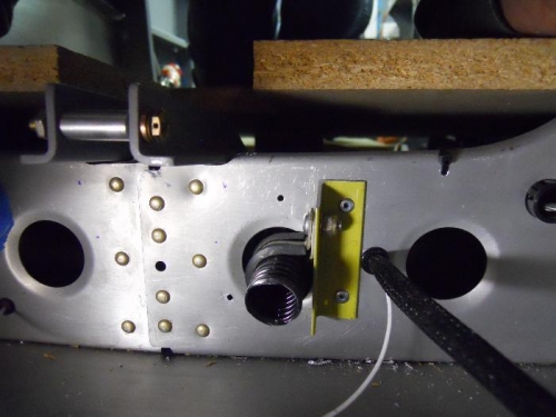

Brief Description:  Under Floor Conduit-2

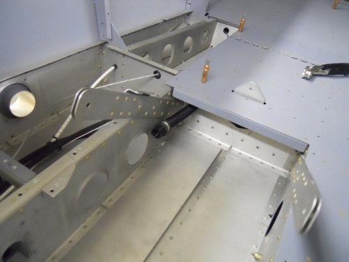

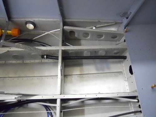

Fabbed a small angle which I pop riveted to the bulkhead. I added an adel clamp to secure the conduit at the F807 bulkhead. On the forward end of conduit, I added another adel clamp to the F814 seat rib. Installed the baggage floor and the rear floor. With removal of only the front floor, I will have access to the conduit for any future wiring needs without drilling out rivets in the other floors.
Adel clamp at
Adel clamp at
