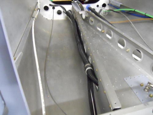

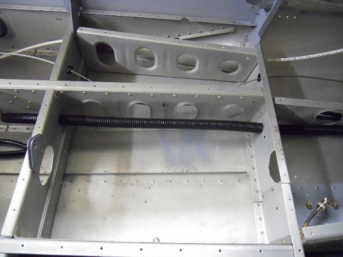

Happy Thanksgiving! With a house full of kids, there was not much time for the plane today. After lunch, while everyone was napping, I managed to get in a bit of shop time. I plan to rivet my floors in—so I wanted to make sure I had a way to get any future wires installed without removing the floors. I cut a couple of holes with a unibit, then installed a length of corrugated conduit along the right side of the fuse to extend into the tail cone--just past the battery mount. Secured with an adel clamp and added some tie wraps. Still need to add a couple more clamps.
Conduit passing thru ribs
