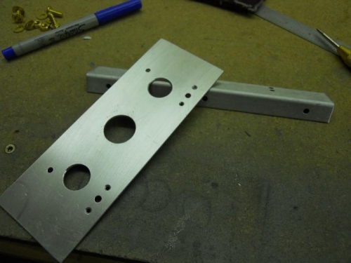

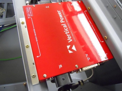

I made a template which I clamped to the forward brace . Then, I match drilled thru the holes already in the brace into the template. Transferred the template holes to the mounting plate. I drilled pilot holes in the attach angle, then screwed the angle and the mounting plate to the VP-X. Clamped everything in position and match drilled #19 the angle to the crossbar. Removed the mount and angle from the VP-X and deburred all holes. Cut some lightening holes in the mounting plate. Used a nutplate jig to drill holes in the mounting plate for some K-1000 nutplates. Countersunk the holes for NAS 1097 rivets to attach the nutplates. Scuffed the angle and the mounting plate. Tomorrow I’ll shoot some primer on these parts.
Test fit of the VP-X
Mounting plate and attach angle ready for primer
