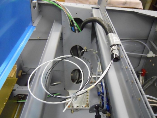

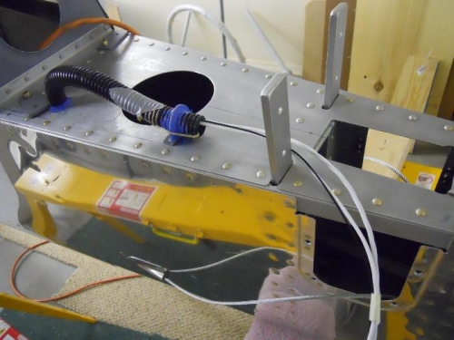

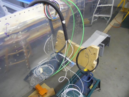

I received an order of wire, terminals, switchs etc today. Before the rear deck was riveted on, I had installed some of Van’s corrugated conduit running from the tail to the instrument panel area. I had installed a string thru the conduit using a cotton ball pushed with compressed air. I tied (taped) a 3 conductor wire (tail & strobe), a 5 conductor wire (elevator trim motor), a single wire to return to ground and another string to the existing pull string. Pulled the wire bundle thru without issue. I have a ton of wiring to go, but finally got it started.
Beginning to pull wires toward the tail
Wires from the tail
Wires from the tail
Wires at the tail
Wires at the tail
