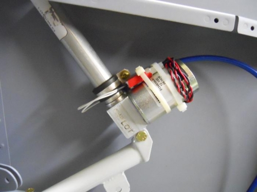

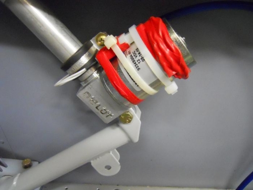

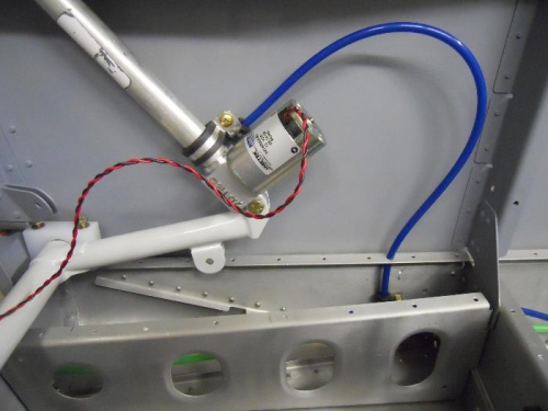

Brief Description:  Flap Motor Connectorized
Made the connection between the flap motor and the wires running to the front of the plane. Picked up a small 2 pin connector from Radio Shack. Crimped the pins, added some heat shrink and inserted into the connectors. Secured the flap motor wires and the connector to the flap motor with a couple of zip ties. Added some self fusing tape to make sure nothing can wiggle loose. The white tefzel wires are fed into the blue static line to protect them during movement of the flap actuator.
Need to connect some wires here
Added 2 pin connector
Secured with self fusing tape
