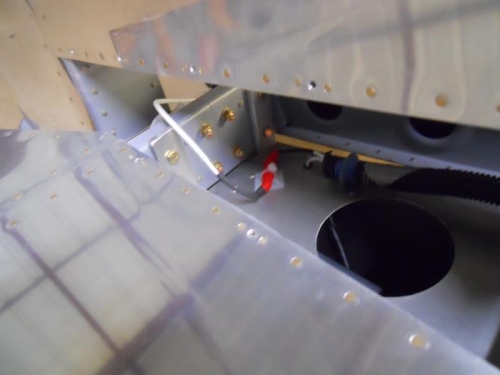

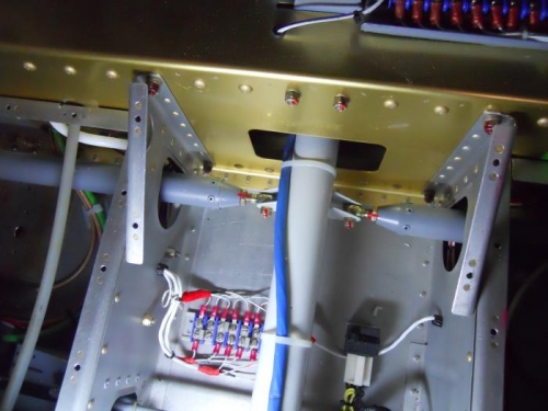

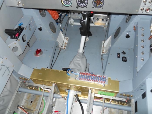

I secured the elevator trim wiring with a zip tie, then installed the three bolts that attach the rudder to the vertical stab. When I put the temp pins in, I inserted them from the bottom, then I used the bolts to push the pins out as the bolt was going in. Pretty easy—however, it is much harder to get the washers and nuts on the bolts. I finally used some Easy Turn (super, super sticky) to attach the washer to the nut and the nut to the end of my finger. Got them all tightened up and marked with torque seal. Next, I adjusted the aileron control tubes to get the ailerons both matching in neutral position. Then, I tightened up the jam nuts as well as the nuts securing the tubes to control tube—marked with torque seal. Next, I installed the left and right F-881-1 mid cabin covers. I first had to remove the Andair fuel valve handle, install the left cover, then re-install the handle. On the right cover, I attached wires for the Hobbs meter, the 12v accessory socket and the ELT remote switch.
Secured trim wiring
Secured trim wiring
Rigged ailerons
Rigged ailerons
Mid cabin covers installed
