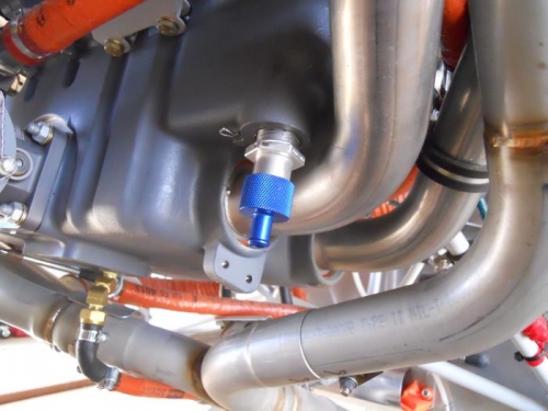

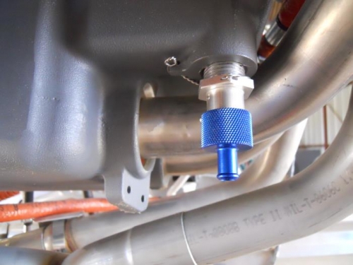

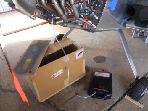

I cut the safety wire and removed the right front oil drain plug, thus draining the preservative oil. I raised the tail and left it so I could get most of the oil drained. I was going to pull the lower spark plugs and empty the cylinders—but, my plug wrench is at my house! While the oil was draining, I installed cotter pins in several bolts on the engine mixture and throttle linkage. I cleaned up around the oil drain hole. Then, I coated my quick drain with some anti-seize goop that came with the plug and installed it. I’m using a Saf-Air P5000 quick drain. Then, I safety wired the plug. I have some vinyl tubing that just fits over the end of the quick drain—hopefully this should make for a relative “mess free” oil change. After I get the cylinders drained, I’ll refill the engine with Phillips M20W50 mineral oil for the break in period.
Quick drain
Quick drain
Safety wired
Safety wired
Oil drain setup
Oil drain setup
