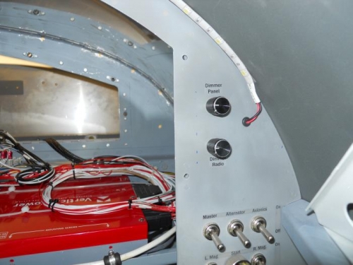

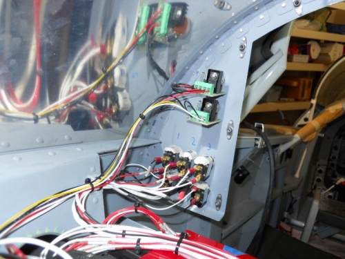

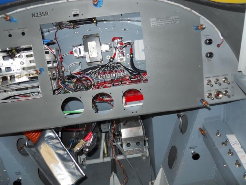

I drilled a hole in the sub panel and installed a small rubber grommet. I fed the wires from the LEDs and attached them to the dimmer. I finished up attaching the rest of the wires to both the glare shield dimmer and the audio panel dimmer—checked operation of the LEDs—good news, they still work. Next, I applied some decals for the 2 dimmer switches, then clecoed in the instrument panel. I installed some pinch welt around the edge of the glare shield—this was a perfect spot to receive a nasty cut in the event of a very sudden stop. Of course the seat harness should keep you from striking the glare shield, but I hope to never test that theory. The down side of adding the pinch welt was that I had to remove the rubber line I had cemented in to dress up the joint between the glare shield and the windscreen. I’ll pick up some more and glue it back in.
Back side of sub panel with dimmers
Dimmers on sub panel
Clecoed in the instrument panel
