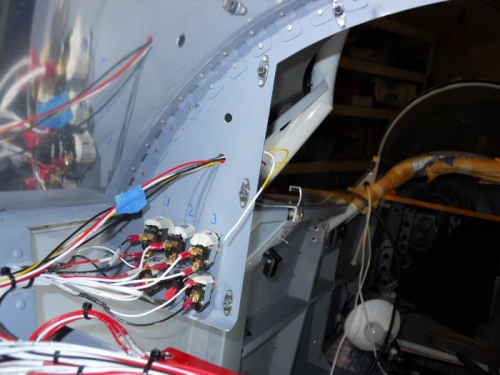

Brief Description:  Wire run for dimmers
I originally had the dimmer for the audio panel on the switch panel, but moved it to instrument sub panel. I pulled out some of the old wiring and ran new. I also ran wires for the LED’s under the glare shield. Without the avionics access door, it would have been extremely difficult to run the new wiring. I also programmed the VP-X for the new circuit to handle the LED’s. Tomorrow I hope to get the wiring tied in to the dimmers and also get the panel labeled.
Wiring run for dimmers
