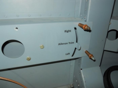

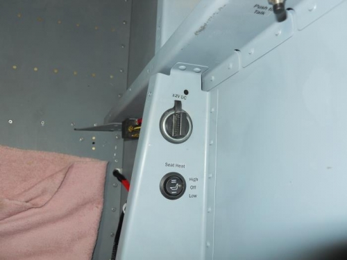

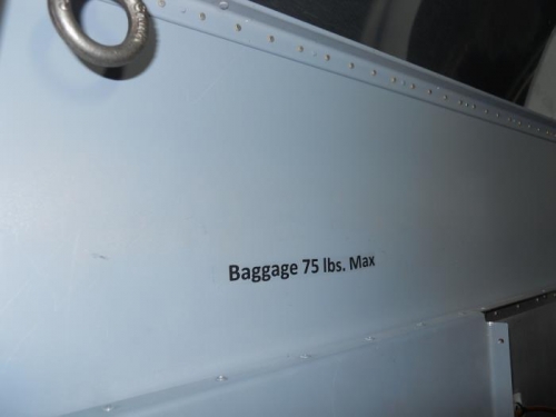

Post 2 of 2. Here are some pics of the labels. I printed the labels on clear decal paper. After printing, I sprayed the sheet with decal bonder to keep the ink from running. Then, I cut them out, soaked in water and applied. After the labels were applied, I sprayed them with a sealer.
