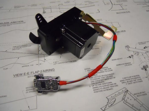

Brief Description:  Roll servo install-1

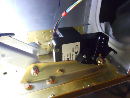

I received some parts from Stein today—I needed a male d-sub connector for the Dynon roll servo. I crimped on the pins and inserted into the connector, then added the shell. Next I installed the supplied limiting bracket. On the rear mounting bracket, I drilled a 1/16” hole to secure the safety wire for the bolt on the back of the servo. Then I installed the servo in the right wing—I don’t remember it being so tight in there. I torqued all the bolts to 25”/lbs. I still need to safety wire 3 bolts—should be fun in the confined space.
Wired d-sub plug for servo
Servo mounted in wing
