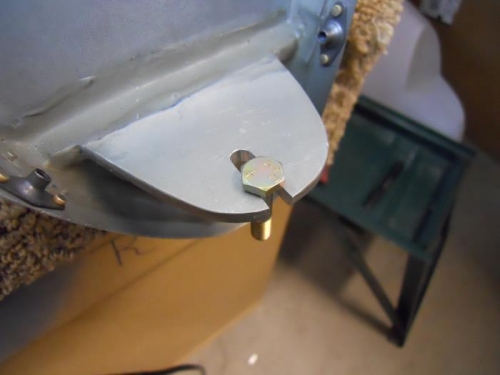

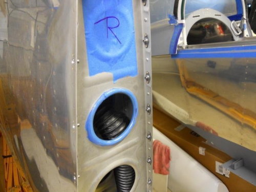

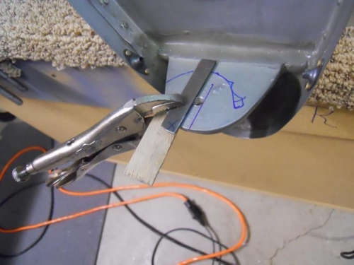

I almost finished up all of the nutplate attachments for the right wing today. I squeezed in NAS 1097 rivets to secure the nutplates from the spar forward—all except one right next to the spar. I’m waiting on some MS21053-L03 single lug nutplates from ACS. Then I turned to the aft upper fairing attachments. Squeezed in all rivets for these nutplates also. I wanted to cut the slot in the T-405 fuel tank tab while I had the wing propped up in the cradle. I drew a couple of parallel lines, clamped on my steel “fence” and cut the slot with my dremel, followed by filing and finally with some fine grit paper.
Finished most of nutplate attachments on R. wing
Guide for cutting slot in tank tab
Bolt slides smoothly in slot
