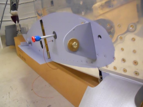

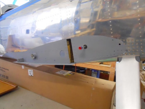

When the wings were on the plane, I traced the outline of the wing root onto the fuse. Starting on the right side, I ran a line of tape along this line, then scuffed up with a scotchbrite pad. I taped off the surrounding area and shot a coat of primer. After the primer was dry, I removed all tape, then repeat for the left side. After both sides were good and dry, I installed the tank attach brackets.
R. side primered
R. side primered
Tank attach bracket installed
