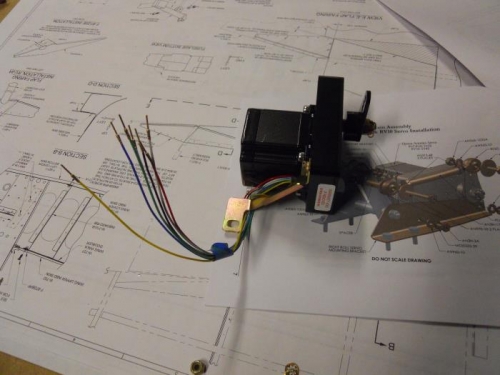

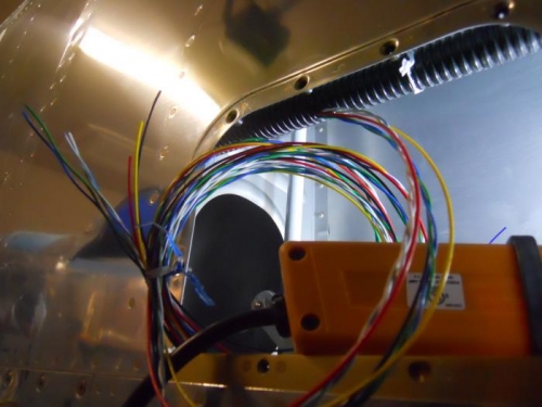

Today’s plan was to get wiring for the Dynon roll servo (to be installed in the right wing) finished up and then install the servo. I tied a cotton ball to some string and blew it down the corrugated conduit using compressed air. I used a soldering iron to open a hole in the conduit and pulled the seven wires for the servo down the wing. I stripped and crimped on some pins on the leads from the servo. Well, I was short one DB9 male socket, so the rest of this is on hold for a few days.
D-sub pins crimped on servo leads
Wiring for servo-exiting conduit
