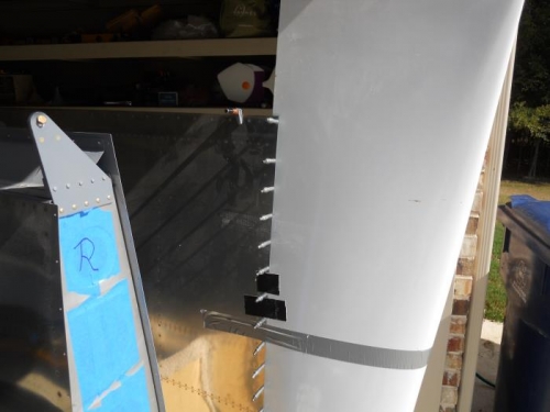

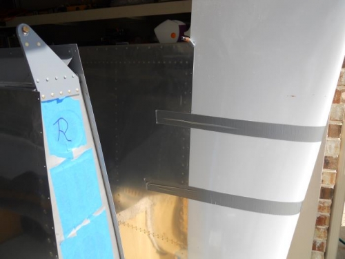

I sanded the edges of the wing tip a bit more until I had a very good fit. I worked slowly with many trial fits until I good a nice looking line. I used Gorilla tape to hold the wingtip in position, then match drilled thru the existing holes in the skin into the flange of the fiberglass tip.
Wing tip taped into position
