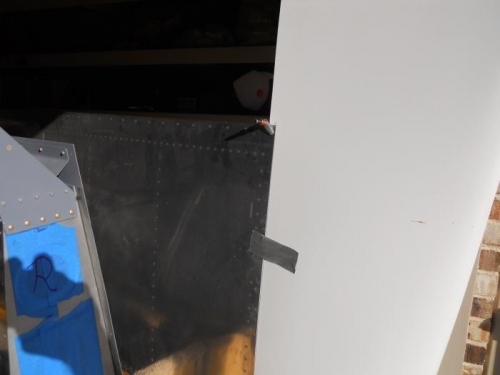

Brief Description:  Wing tip install-1 part 2 0f 2-left side
Started on wing tips today. I plan to use the “hidden piano hinge” method of attachment. First up was to fit the tip to the wing—this required sanding the edge from around 1/16” at the nose to 1/8” near the aft end. Fit is better, but I want to fine tune it just a bit more before I began drilling holes.
Pic not great, but sanded edge to fit wing
