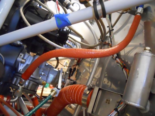

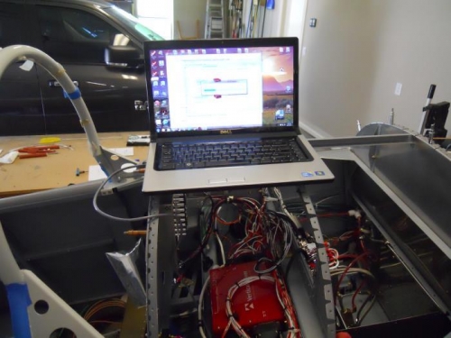

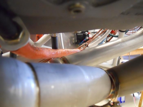

Brief Description:  Installed some firesleeves, begin config on VP-X
When my engine arrived, there were two fuel lines which I replaced—line from the fuel pump to servo and a line from servo to spider. I replaced the first line with one supplied by Van’s in the f/w forward kit. The second line was replaced by 2 custom made lines in order to put the red cube between the servo and spider. I tried to sell both extra lines on VAF, but no one was interested—they probably went thru the same replacements as I did. So, I cut the bands holding the firesleeves and removed the sleeve material. I cut the smaller line to fit the fuel pressure line from fuel pump to manifold and cut the other to fit over the throttle cable. I coated the cut ends with a mixture of high temp RTV which I thinned down with MEK to make it less viscous. Installed both fire sleeves. I also finished checking the VP-X wiring connections today per the instructions. So, I connected my laptop to the VP-X, did a firmware update, and then uploaded by configuration file. It all seemed to work without issues. In the next session, I will further verify all of the switch settings and device configurations. I need to decide on paint color for the panel soon—the top skin is calling my name to be riveted on!
Firesleeve on fuel pressure line
Firesleeve on throttle cable
Laptop connected to VP-X
