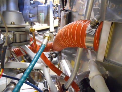

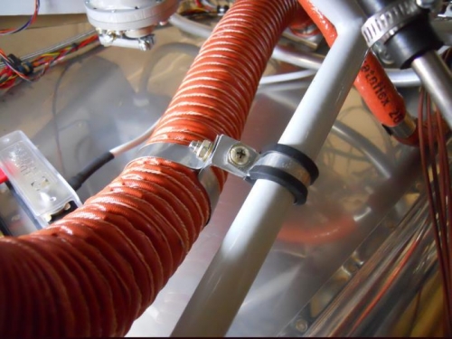

I ran the positive wire for the seat heaters and connected to the VP-X. However, I wanted to run black wire for the ground, but don’t have enough—another order In process—UPS guy is getting really friendly! So, I decided to connect up the fresh air vent inside the cabin. I pulled out the scat tubing and thought I would connect the heat muff to the cabin inlet valve as well. Hmm, turned out that took quite a bit longer than I thought possible. I made up a small piece of angle per the plans and used it to connect a stainless steel strap to an adel clamp. Clamped the parts together and secured to one of the motor mount tubes. Then I added hose clamps on each end—got decent clearance and nothing flopping around. Sounds simple enough-and would have been if I had hands the size of a small child. There just isn’t much room between the engine, the firewall, the exhaust and all the other misc. stuff.
SS strap attaches hose to motor mount
Heat muff to scat tube
Scat tube to cabin heat valve
