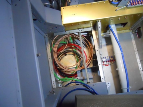

Brief Description:  Ran taxi & landing light wires

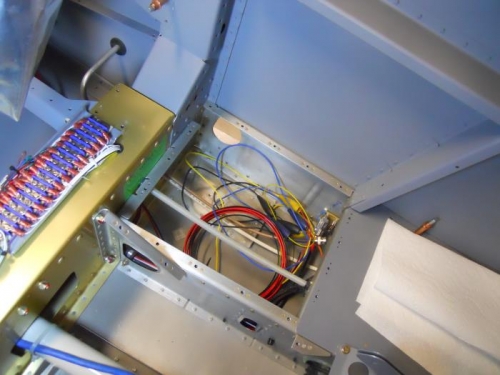

I ran power and ground wires for the landing and taxi lights today. I coiled up the excess and left it in the lower fuselage somewhere near where I think they will run out to the wings. Also ran some RG400 coax on the left side for a NAV antenna—also left the excess in the fuse. I terminated the ground wires for the lights to the forest of tabs and plugged the power wires into the VP-X. While running the wires on the left side, I also ran the wire from the EMS for the fuel level sensor to the same location as the light wires. I ran the wire for the right fuel level sensor across the bulkhead toward the right gear tower. This wire will need to be spliced—just not enough to get to the fuel tank. I need a BNC connector to terminate the NAV coax at the back of the GTN. I think all wires have now been run on the left side. I still need to run the seat heater wires on the right side—maybe tomorrow.
Wad of wires waiting on wing install
Right side wires-also waiting for wing install
