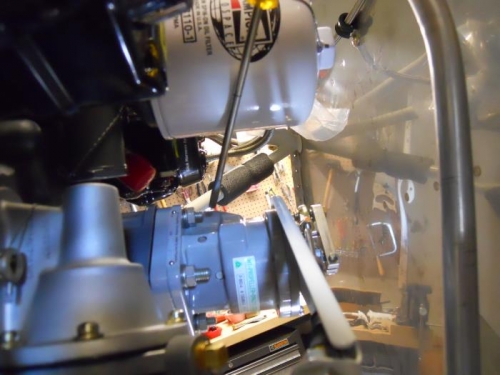

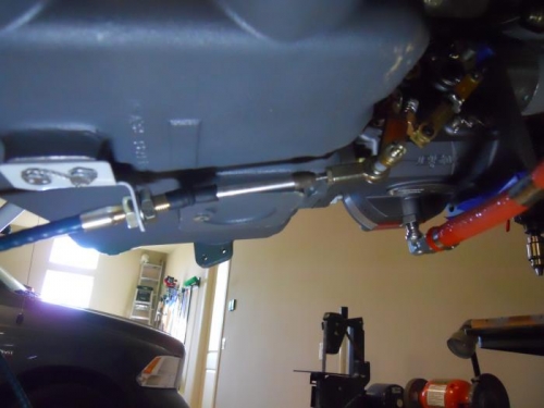

Hooked up throttle cable to the linkage assembly on the fuel servo and adjusted for “go slow and go fast”! Next, I began installing the prop governor cable to the governor bracket. The plans suggest installing and adjusting the cable before actually mounting the governor to the engine. So, I installed and adjusted the cable, and then installed the governor. Three of the mounting bolts can be accessed (with difficulty), but the top bolt is going to be a problem. Access would be better without the oil filter in place, but I hope I don’t have to remove it—guess that will be plan B. Tomorrow I’ll try grinding or cutting up a wrench to see if I can get at the bolt.
Throttle cable to servo

Screwdriver points to pesky bolt
