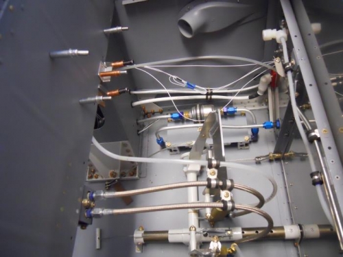

Brief Description:  Re-route plastic brake lines

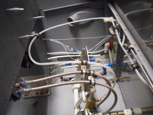

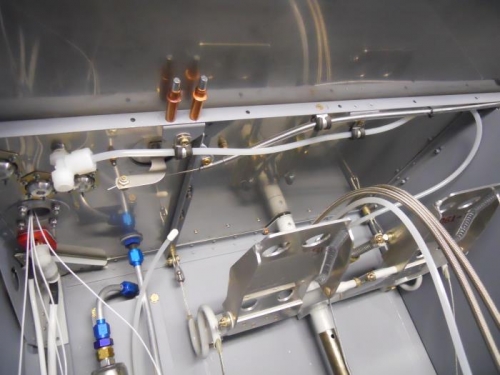

I decided to re-route the plastic brake lines that run from the master cylinders to the brake fluid reservoir for 2 reasons. First, I needed to get the lines away from the bottom of the F866A-1 lower baggage bulkhead on which I have the EMS module mounted—I’m thinking I might have had an interference problem with connections. Second, I just like the look of it. I saw this mod on someone’s site early on in the build, but don’t know who the builder was—thanks anyhow. I made 2 brackets to secure the right plastic line to the angle that runs across the back side of the firewall and another bracket to secure the left line to the F866A-1 bulkhead. I attached all angles with monel pop rivets. The right is now complete—before I finish the left side I need a smaller clamp to secure the line. This was the last item on my list before hanging the engine—hope to start that task in the next few days.
Attaching right line to angle

Attaching bracket for left line
Done,except need a smaller clamp on bulkhead
