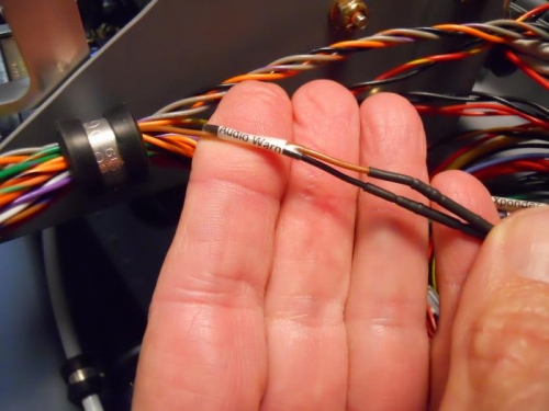

Brief Description:  Failsafe warinig audio connected

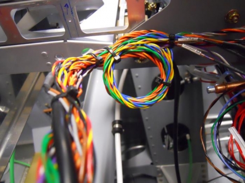

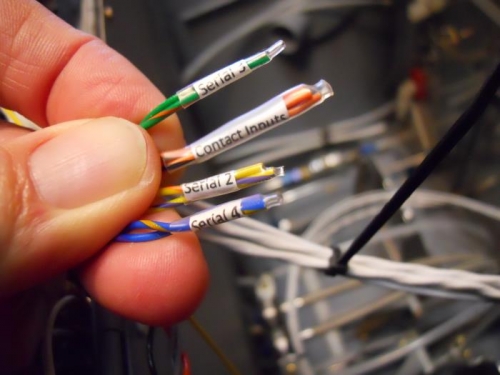

I used d-sub pins and barrels to connect the “failsafe warning audio” wires between the GMA240 and the Dynon D-1000. Then I grouped all of the unused wires and labeled them by group. I made a service loop of the wires and secured with zip ties. Other than the dimmer wire, this pretty much finishes up most of the wiring until the other Dynon modules arrive.
failsafe warning audio connected

Grouped unused wires and labeled

Service loop of unused wires
