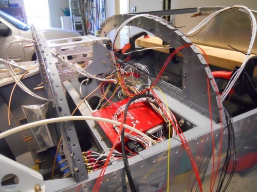

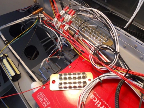

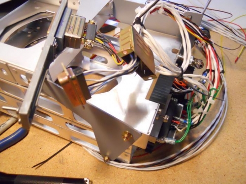

Ok, back to wiring. I installed the radio trays with harnesses attached and began planning how to run the wires. The first issue was obvious-I need more connectors on the forest of ground tabs, so I removed the 24 tab connector and installed a 48 tab connector. The ground and power wires should be no problem, and the AIRINC and EMS wires should be easy once I get those two modules installed. Easy-Peasy! Well almost. A couple of years back, I ran wires and connected mic/phone jacks for pilot and co-pilot. When I ordered the radios and wiring harness, I told Stein that I already had run wiring for mic/phones, so the harness did not include these wires. Now, I will have to partially disassemble the connectors in the harness in order to connect wires to the GMA240 audio panel. Not a big deal, just going to take longer than I thought to get the harness finalized. So, I removed the radio trays, removed the connector from the audio panel and began taking apart the first plug-in housing in order to add pins and wires.
Yikes!  Wires everywhere!
Replaced ground tab
Replaced ground tab
Began disassembly of audio panel connectors
