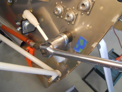

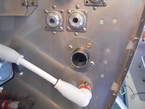

I received a couple of firewall pass through kits from Avery last week, so I worked on them for a bit (putting off the radio wiring??—maybe). I marked a location on the firewall below the eyeballs for the control cables and center punched. Drilled a 1/8” hole, then used a step drill to open up to a ¾”. I used a 1” knock out punch which makes a 1 1/8” hole. Used part of the pass thru as a template to drill the 4 mounting holes to #19. Deburred all holes. I need to add some firebarrier before permanently installing the pass through. Also, need to decide if I need a total of 2 pass throughs, or if one will be enough. Probably need the sensor kit for the EMS to know for sure.
Knock out punch cutting hole
Pass thru installed-need to add fire barrier
