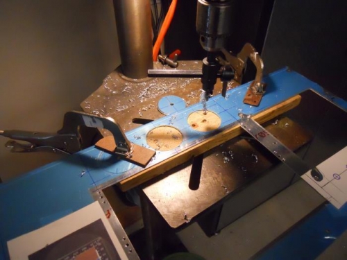

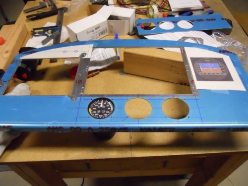

I clamped the instrument panel to the drill press table and fired up the fly cutter. Slowly and carefully I cut the first circle. Checked the diameter with one of the instruments and was satisfied with the fit, so I cut the other 2 holes. Next, I drilled out the mounting holes with a 1/16” drill and then with an 1/8”. Still need to drill them up for a #6 screw (#27 drill), but want to check the panel holes against the instrument holes first. Was too cold to hang in the shop very long today—spring can’t get here soon enough!
Cutting panel with fly cutter
Holes cut-fit looks good
