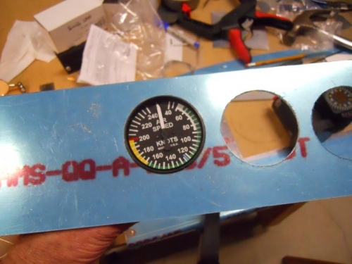

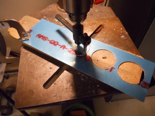

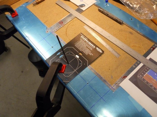

Today, I received a vertical card compass, now I have all 3 of the backup gauges and can continue with panel work. I checked proposed locations for depth to make sure nothing would interfere with the cross brace behind the panel—looks like the round gauges should fit just fine. I re-checked the measurements on the panel, then used an instrument layout template and 1/8” transfer punch to mark the center location for each instrument. I drilled the 3 locations to #40 followed by 1/8” using my drill press. I laid the instrument template over the center of each hole and inserted a 1/8” transfer punch to center the template. I clamped the template and panel together and center punched all of the mounting screw locations using another 1/8” transfer punch. I had previously used a ATS hole punch on some scrap, but the hole is slightly undersized for the A/S and altimeter, so decided to try using the fly cutter. I cut 3 holes in scrap before I got the cutter adjusted so that the instruments perfectly fit the hole. Sure spent a bunch of time and burned thru some good scrap to get the cutter adjusted for the desired result. Next session, I'll use the fly cutter on the panel.
Marking panel for round guages
3rd time cutting a test hole
Finally-a perfect fit
