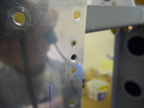

Nutplates attached-top rivet is Cherry CCR264SS3

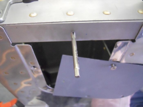

Tapped 6 holes in longeron for #6 screws

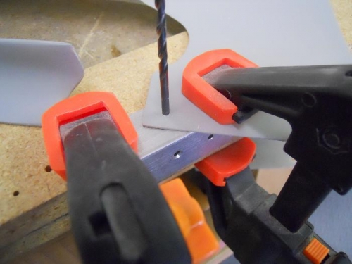

Aligning hole for c/s
