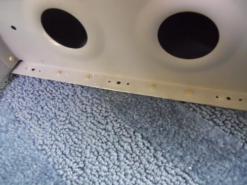

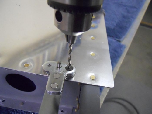

Spent a good bit of time cleaning up my work table. It looked like I had most all of my tools scattered about-not enough room to lay the VS down. After putting away all the tools etc, I removed the VS. Deburred the 12 holes which were drilled to #28 for the fairing attachment—then used a #6 nutplate jig to drill the 24 holes for nutplate attachment. Deburred these holes-now ready for a small countersink for NAS rivets.
Using nutplate jig to drill for nutplates
VS drilled for nutplates-24 holes for NAS rivets
