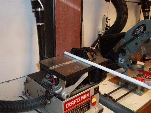

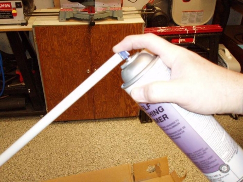

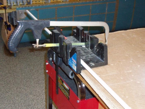

I made the smaller push rod which is the one that goes between the aileron and bellcrank. I cut it to length on the mitre box with a hand hack saw. This worked fine. The mitre box helps make a straight cut. Then I square off the ends on the belt sander. I sprayed primer in the tube. I guess spraying primer in there helps.
Cutting pushrod to length
Squaring off ends on sander
Spraying primer in the tube.
