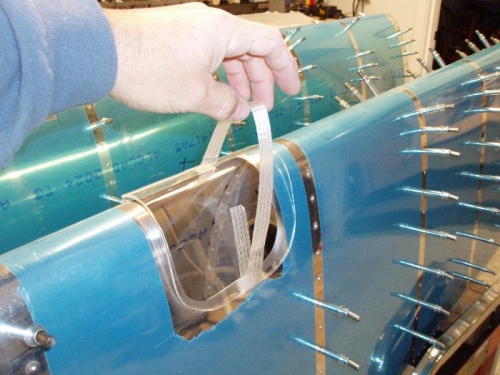

Leading Edge - Landing Light 6 Install Lens
Then I used the tape method to hold the lens in place while I drilled #40 holes. I used regular aluminum bit without incedent. Then I enlarged to #30 bit.
Tape to hold lens in place

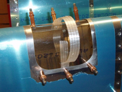

Drilled and clecoed #40

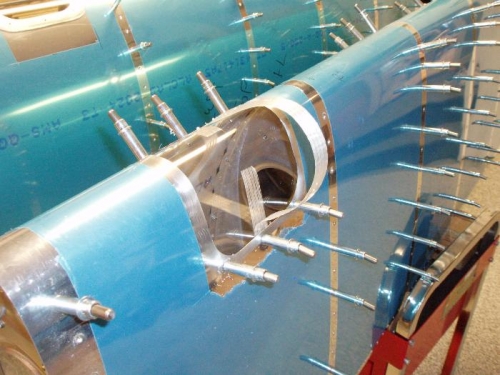

Enlarged to #30.
